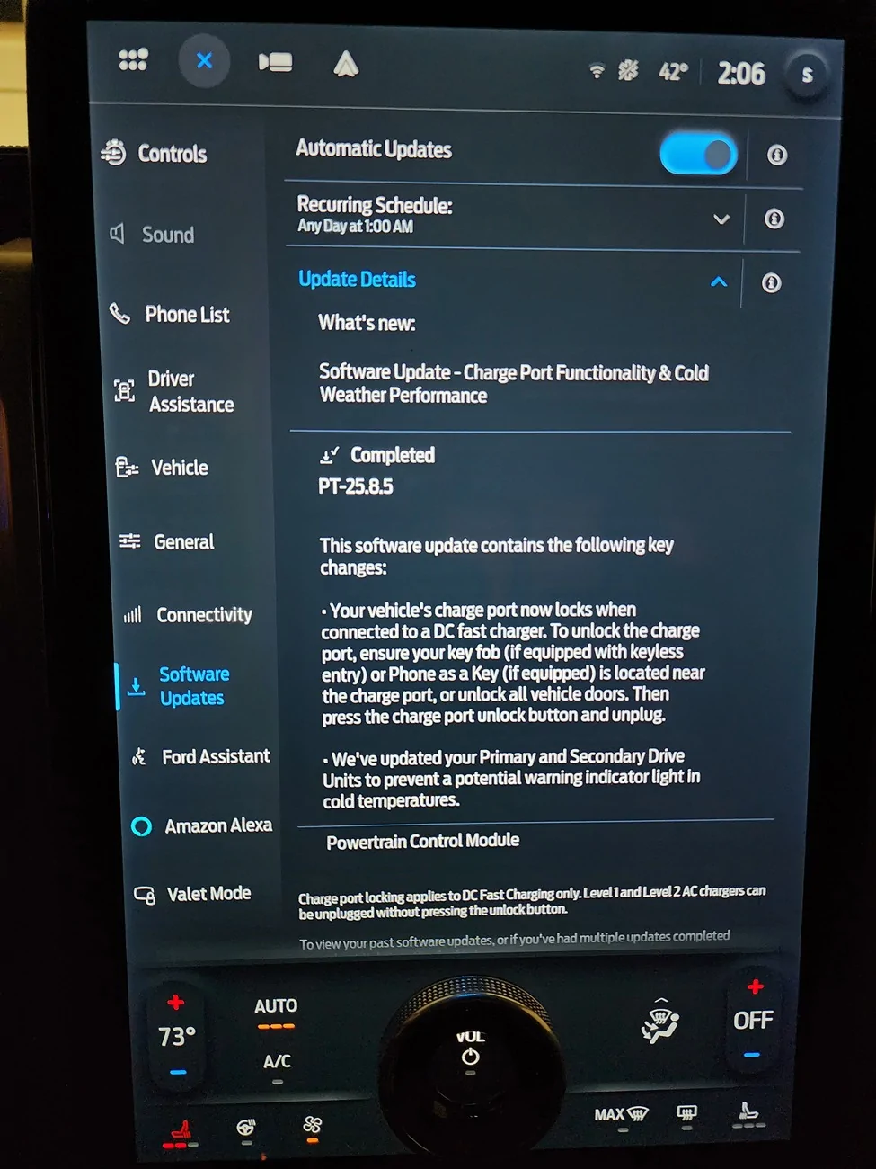

It was a chore, but after several tries, I finally got PT-25.8.5 to work with a new 12 volt battery and turning off automatic headlight.
On the bright side, it is good to know that the update is in place and I have a new, dependable battery for our big trip coming up this weekend.
Ford F-150 Lightning PT-25.13.12 : Charge Port Func. & Cold Weather Performance 1000012771
Ford F-150 Lightning PT-25.13.12 : Charge Port Func. & Cold Weather Performance 1000012772
