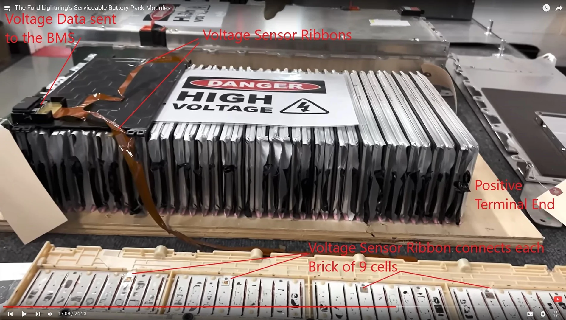

BMS is internal to the battery pack. That's essentially why its plug and play because the truck just gathers and reports the battery status from the pack's internal BMS. The BMS communicates via a serial communication bus so it consolidates all the thermal sensing, contactors, voltage sense, and current balancing wires.
All the battery packs have 9 modules that are in series with one another. For the ER, there are (8) modules of (5P11S) and (1) module of 5P8S. The last single module being a lower overall voltage than the other 8. Cell balancing is done by the BMS for each of the (9) modules down to the cluster of 5 parallel cells. These battery cells are typically very well matched (very close in ESR) so minimal balancing should be required.
Each cell is roughly 81A.
5P11S => 55 total cells. This means there are 11 sets of 5 cells that are in parallel. The 11 set of 5 paralleled cells are then placed in series. Each cell is ~3.7V. Paralleled cells combine for more current. Cells in series increase voltage. So for the 5P11S module, the overall voltage of this module is 40.7V or about 16.5kW overall.
The small module is 5P8S which means it has an overall voltage of 29.6V and about 12kW overall.
This gives us the ER total voltage of 40.7V x (8 modules) + 29.6V x (1 module) = 355.2V.
Each cell is 3.7V x 81A = 300W. Since there are 480 cells in the ER, this gives us 300W x 480 = 144kW. Ford derates the battery capacity by roughly 9% to avoid the extreme conditions of fully charged and completely drained for maximum battery life. After the additional derating, this gives us the advertised 131kWh rating.
