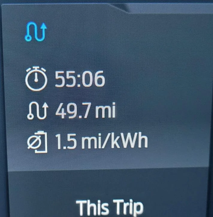

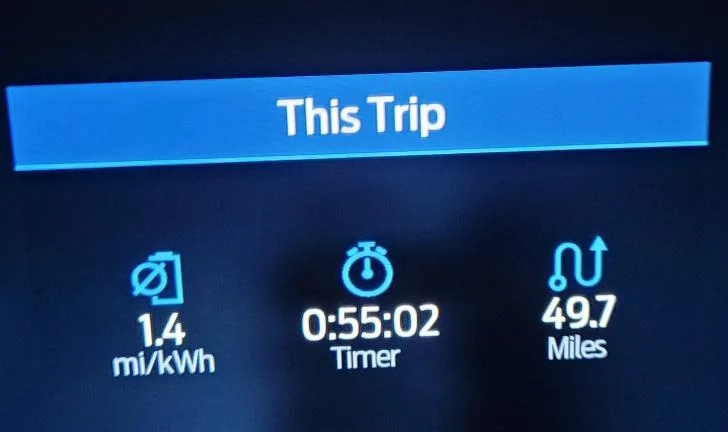

How can you already own an EV yet simultaneously seem to know so little about how range is calculated? It's a guess. It guessed wrong.
And there lies the problem. The GOM used to be accurate. Ford updated it and now it isn't. Ford, in this case, made it worse.
I don't know what I expected from them. They can't even display the same information in two different screens that match.
I noticed that day one. It just gave me a chuckle. I picked the one in the instrument cluster since it is the more conservative of the two. That said, what I care about is the historical usage range as I believe that is more reflective of my overall driving habits.

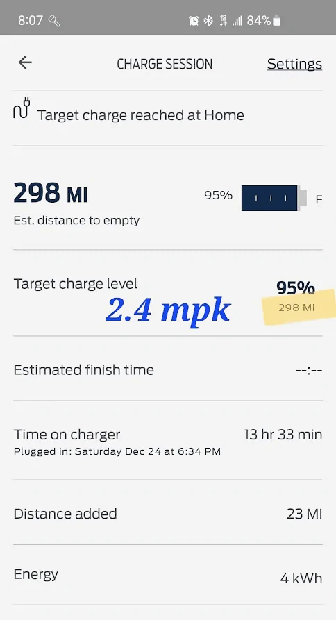

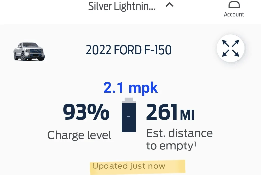

The recent updates 3.5.5 or MIL-DTE e'ffd with the Ford Pass app and truck console predicted range at stated percentages, it's using the summer optimum value of 2.4 MPK..... stick to your drivers cluster current trip MPK value and calculate from the present SOC, as others said above the 1.6 would have been a better prediction use and endurance up and back.
Yesterdays charging session completed at 95%, now way I'm getting 298 miles range, if you use this value you're destined to failure in our cold conditions.
Hopefully the next few weeks of driving history will overwrite our excessively optimistic value with reality, I still would not trust this based on my actual use case, [non-hyper-miler mode of operation] is 1.6 to 1.8 MPK
How are you getting 298 miles in Massachusetts lol. I'm at 200 on the nose with the exact same charging levels.
The algorithms for the dash and Ford Pass are lying to us with the DTE-MIL or 3.5.5 update, if/when you get it DO NOT TRUST IT!
