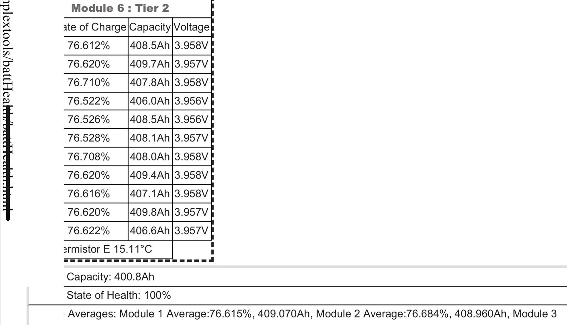

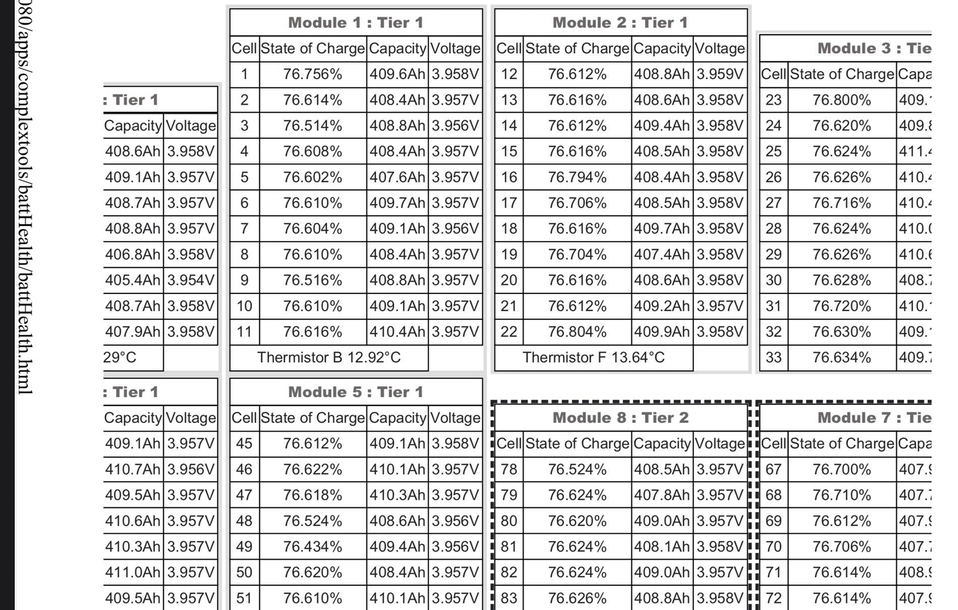

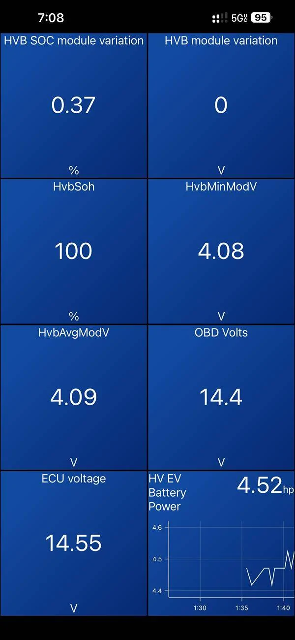

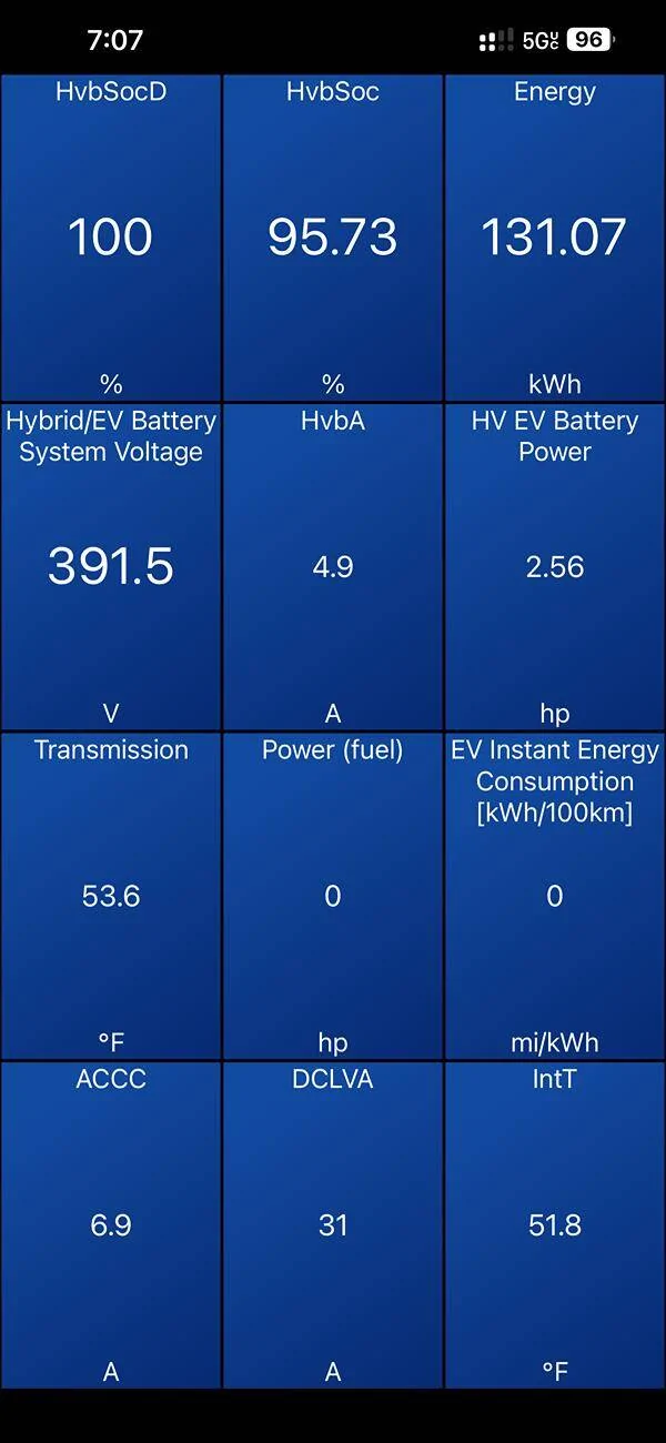

8400 miles. 100% SOH. Fully charged it shows 131.07 kWh. I charge to 80% nightly and 100% before a trip - probably only 5 or 6 Times so far. I’ve probably DCFC 12-15 times - half of those on Tesla superchargers with peak rates as high as 190 kW. I’m not easy on it and have seen over 450 kW draw from the battery during takeoff many times.
I noticed my variation in battery module capacity has gone down after charging to 100% - it was over 16 Ah when I bought it, went to 9.8 the 2nd time I fast charged and now it’s 4.2 Ah.
I thought I had a good printout of the FDRS battery report, but it got truncated

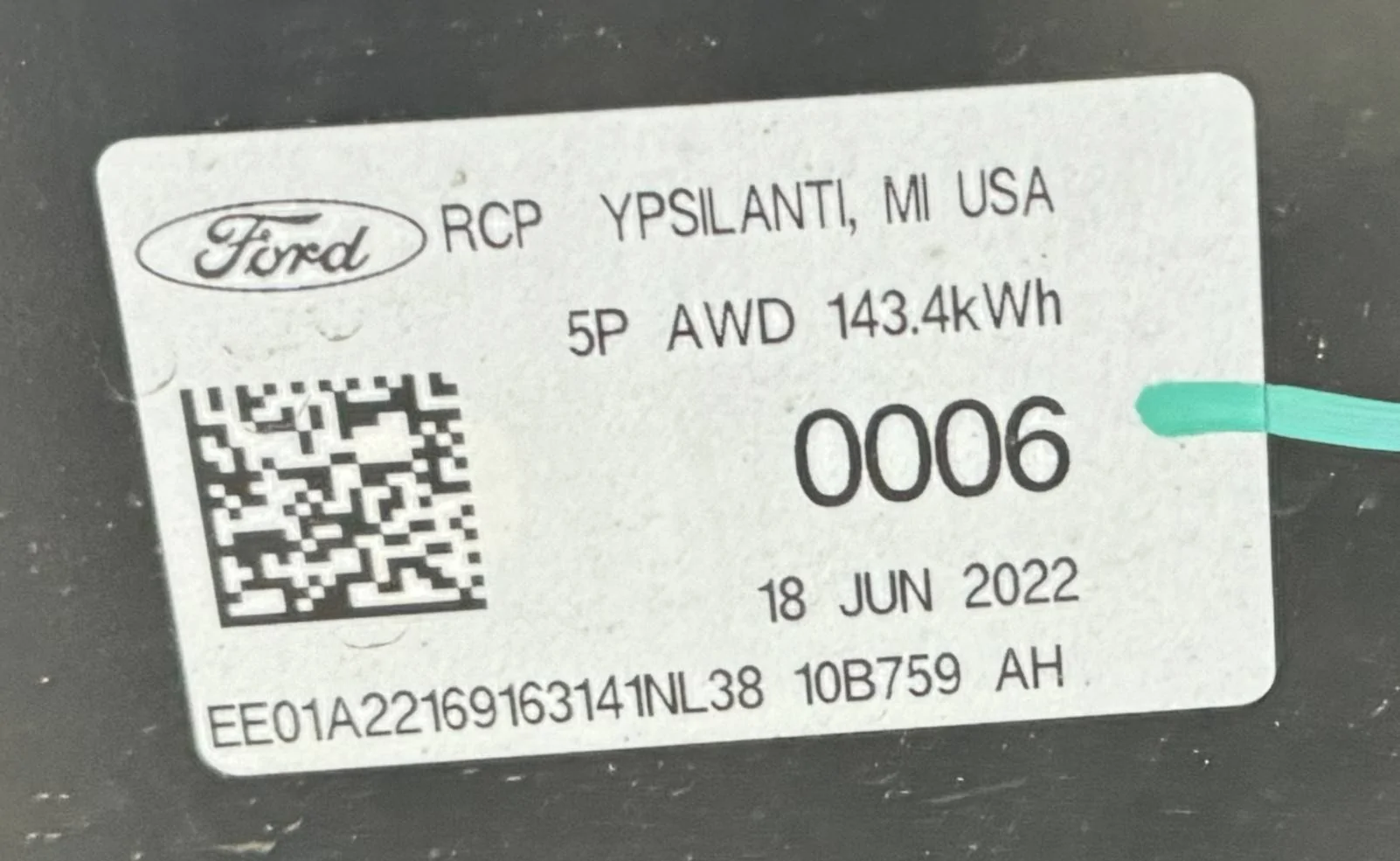

SoH: 100%
30419 miles
Battery age: 35 months (6/18/2022), 1 module replacement (5/2024)
Max average charge: 90% (based on GOM)
DCFC: ~3 times
