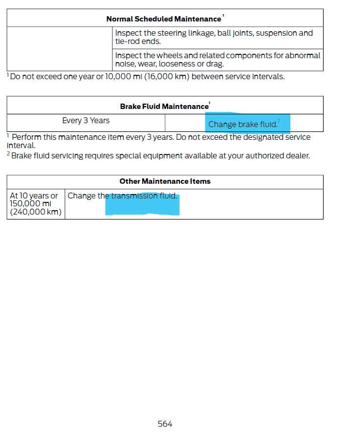

Interesting that my Service tab does not mention this at 150K
2022 owners manual

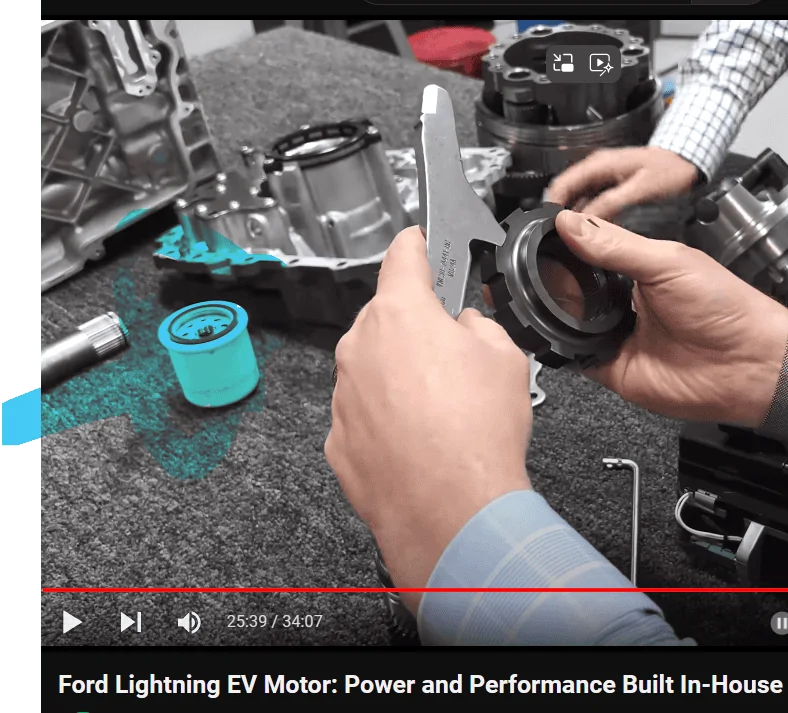

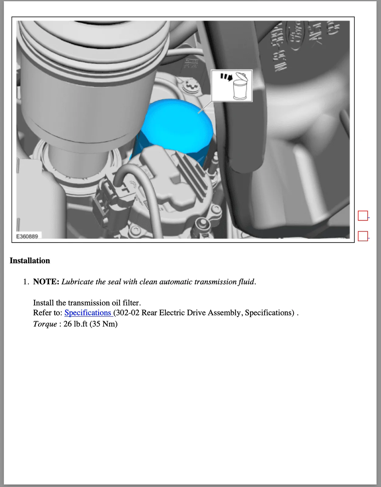

As Shown in the Munro video covering the EDM parts, not talked about but visible

Wow. That gasket is probably Viton or something similar but I'm still surprised it's good for 150,000 miles.

I was shocked to just watch a tesla get an oil change with a oil filter, is there an oil filter on our drives that need to be changed?
There is a transmission oil filter on the drive units that probably get changed with the 150,000 mile fluid change.
2022 owners manual
Could the owner's manual be wrong or out of date. It seems the service schedule is the same for every 10,000 mile interval, and the only added item at 20,000 mile intervals is the cabin air filter.
here's what happens at your 20,000 miles checkup
When I pulled the snap shots, they were from my local static copy of the manuals downloaded months ago, so, I dialed up FORD.COM, logged in and pulled the current version of the manual based on my VIN, this section is basically the same for the 2022 MY.
