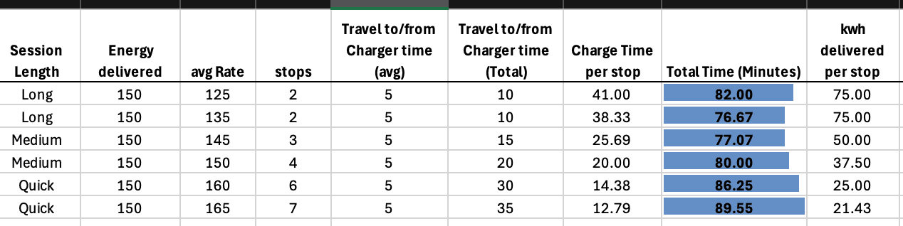

For what its worth... primarily to satiate my own curiosity I put together a quick (non-scientific) spreadsheet comparing the overall time benefit to Long DCFC sessions with less stops vs Short DCFC (Boost) sessions with more stops. Basically I picked an arbitrary amount of KWH that one might need for a road trip. I used 150 as to me that combined with departing with a full battery pack at departure is a healthy ~ 450 mile road road trip.
With Supercharger access this is now an actual legitimate discussion as you can typically be confident another DCFC will be available not too far down the road.
My conclusion, if my charge rate drops below 120kw I am unplugging. Above that I'll probably stick it out.
