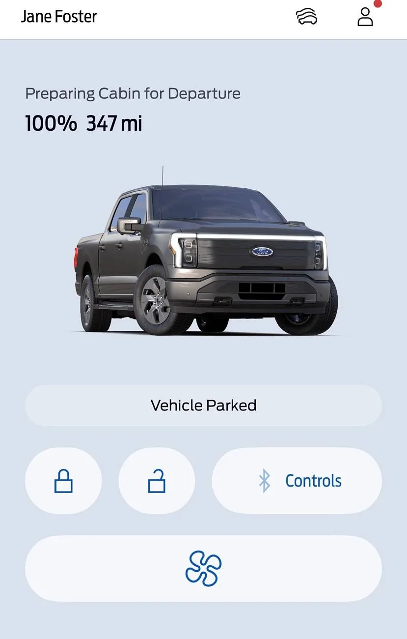

I have had my truck since Aug ‘22. When I charged to 100% the range was 310 or higher.
I unfortunately have had two bad battery modules. The first time I got the “powertrain error”, the second time I was experiencing exactly what you’re describing.
At 100% I would max out at a range of 270 miles and after a few minutes of driving the range would drop to 250 miles. I took the truck to the dealership and they initially told me it was normal but after I demanded they run a diagnostics it was confirmed there was a failed module.
Since my recent repair the battery has been operating as expected.

My 345 miles range at 100% soc when I have never had a trip over 2.2 mi/kwh disagrees with that assessment...
