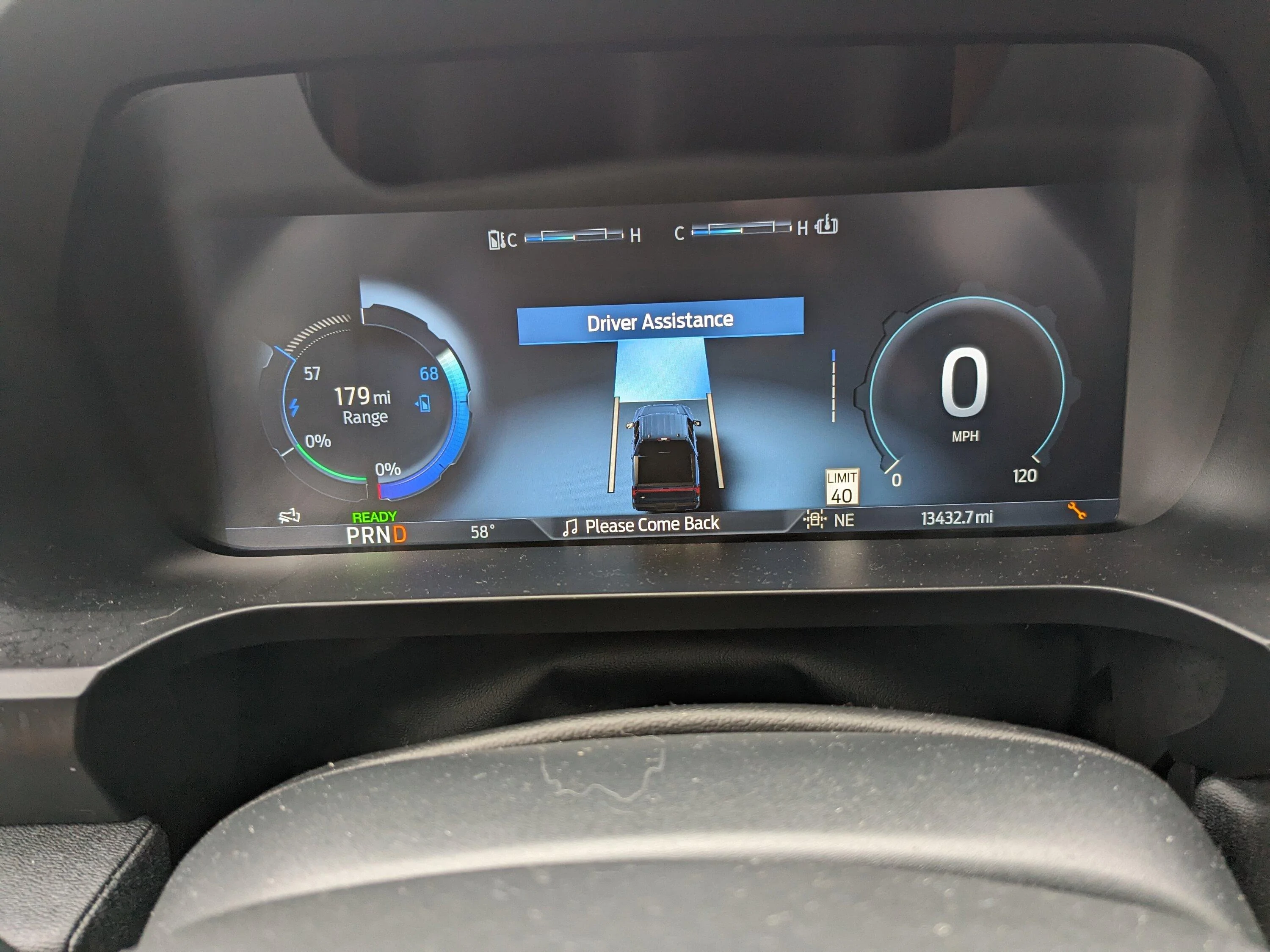

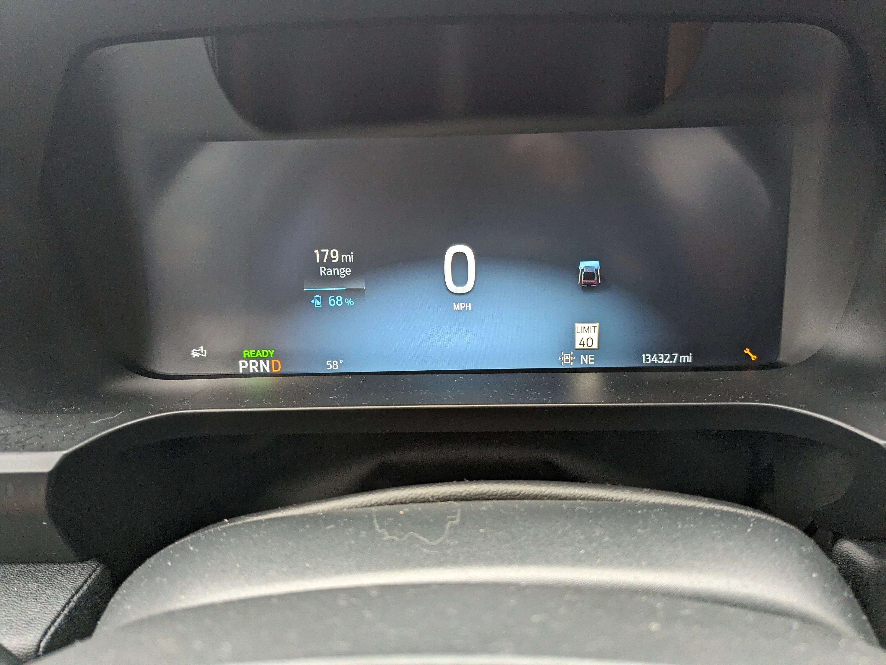

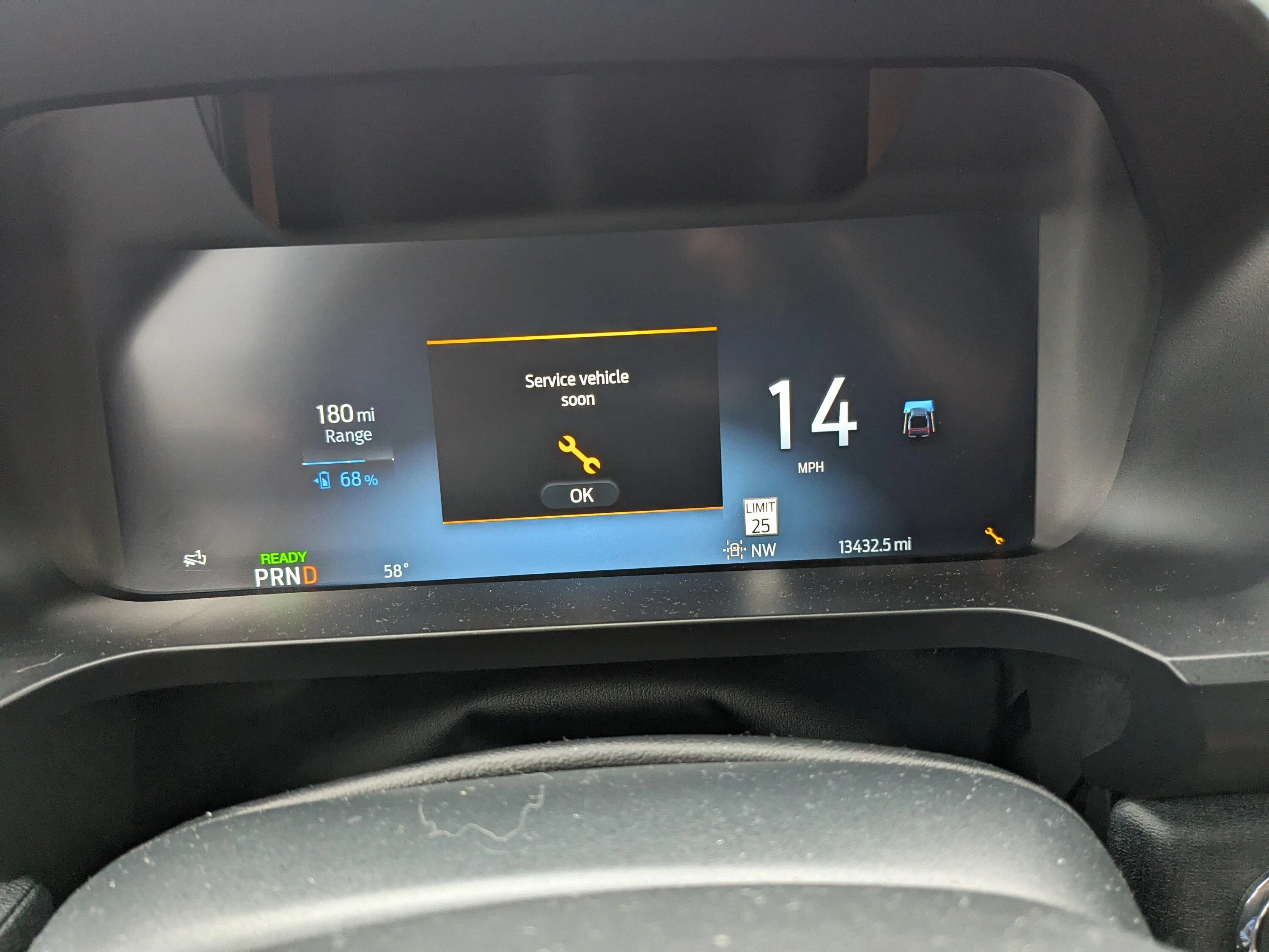

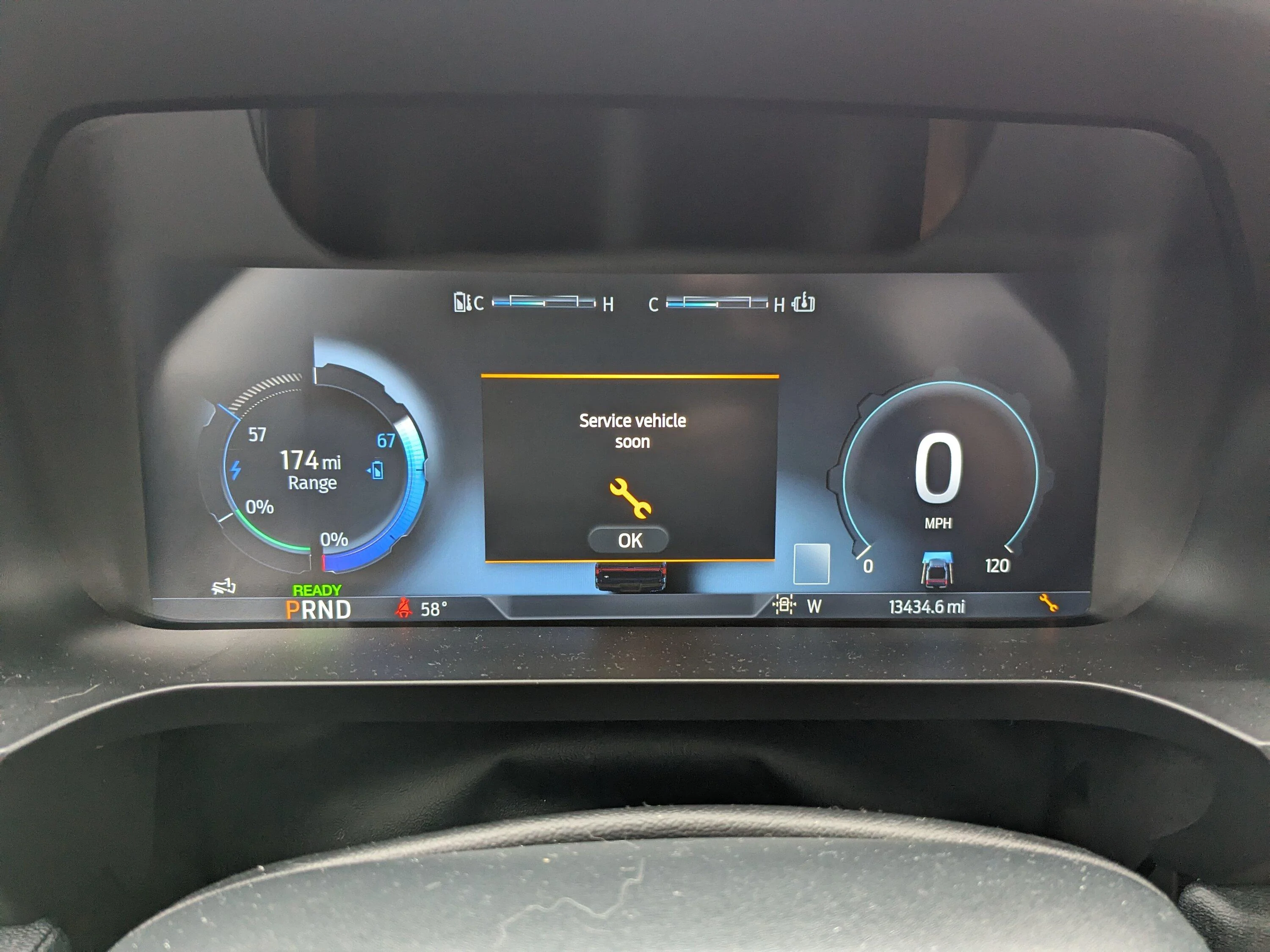

I want to add that I love that it doesn't say anything on the calm screen. I thought it was just a dumb oil change reminder, until I proceeded to nearly rear end a car because my regen was barely there in 1 pedal.
@Ford Motor Company I like to think that I'm a reasonably smart individual.... I think something needs to be improved with the way the vehicle displays errors and changes to the driver. Halving my regen and power nearly caused a car accident this morning because the display didnt show anything other than a tiny yellow icon in the bottom right corner.
When I called the dealer, after telling them the issue, their response was "so what's your question". Yet, when they look it up, they can see through the telematics that there is an issue with the vehicle. If you can send that remotely to the dealerships, you sure as shit can display something more obvious to your drivers behind the wheel.
You guys have to be better at the software and how you communicate these things to your owners. This is pathetic and dangerous.
Also, I just read this thread and saw the comments about AC charging not working. I went out and plugged it in, and low and behold, won't charge. Great.

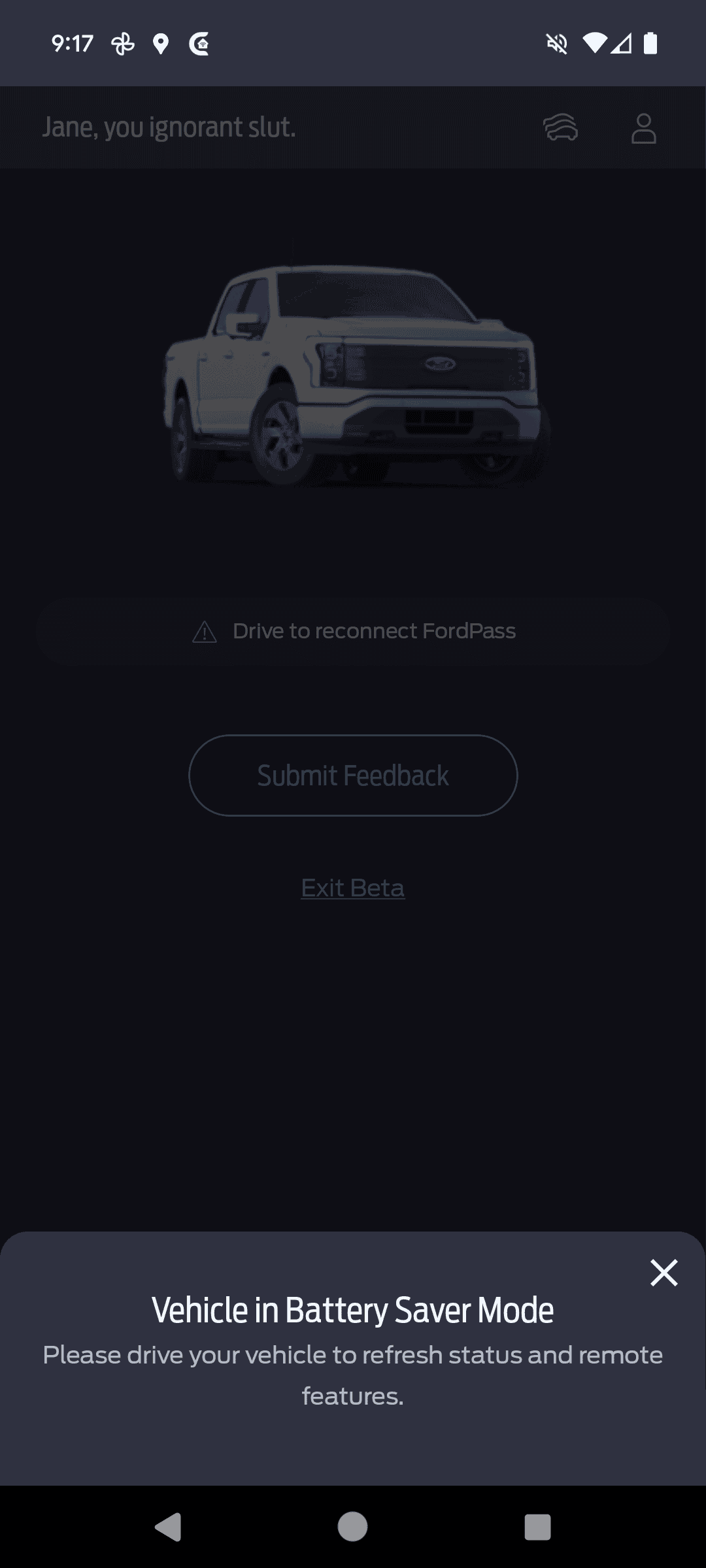

My truck has sat so long, I now get this when I check the Ford pass app:
Ford F-150 Lightning Powertrain Malfunction/Reduced Power Poll 1000021360
