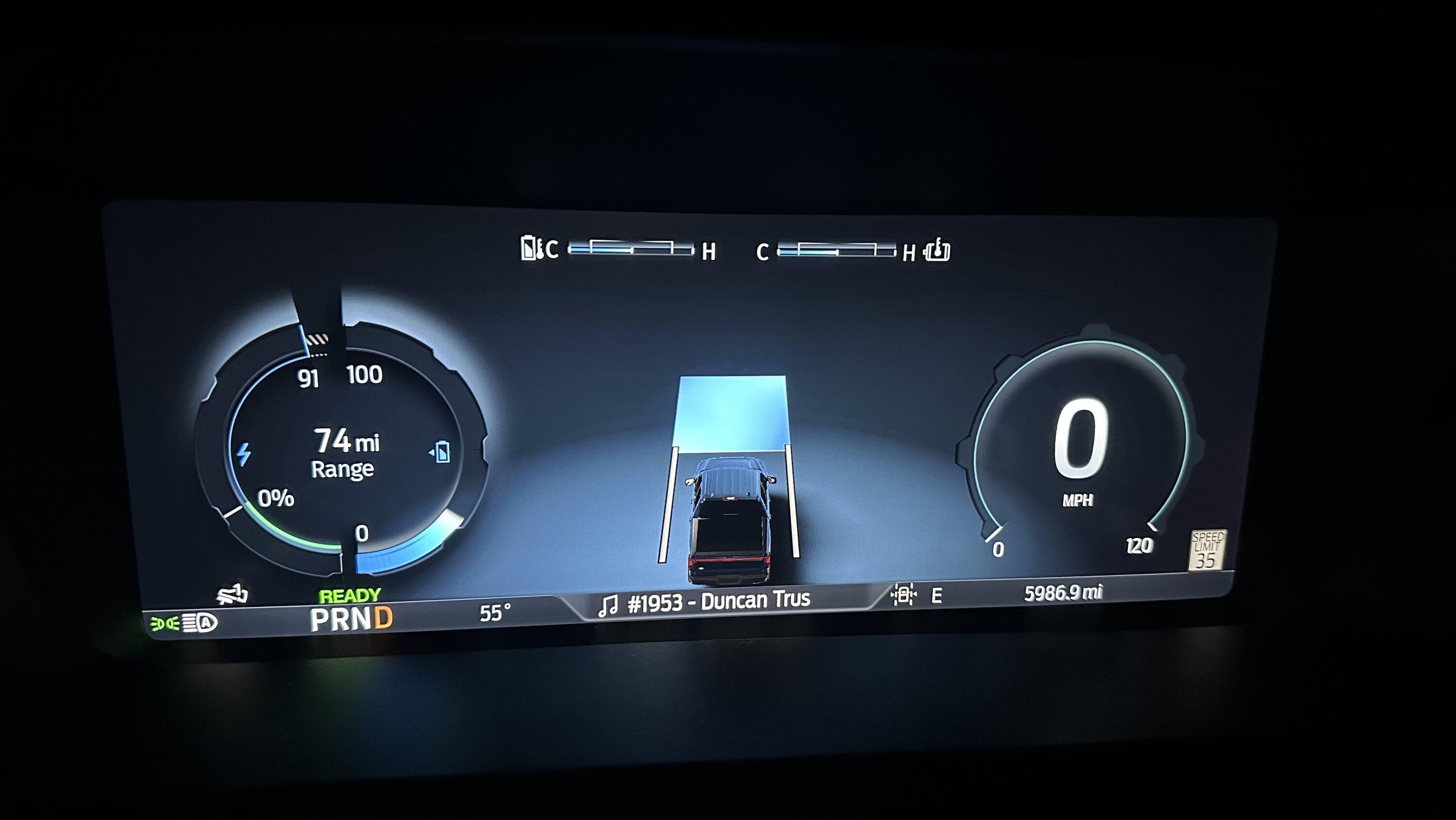

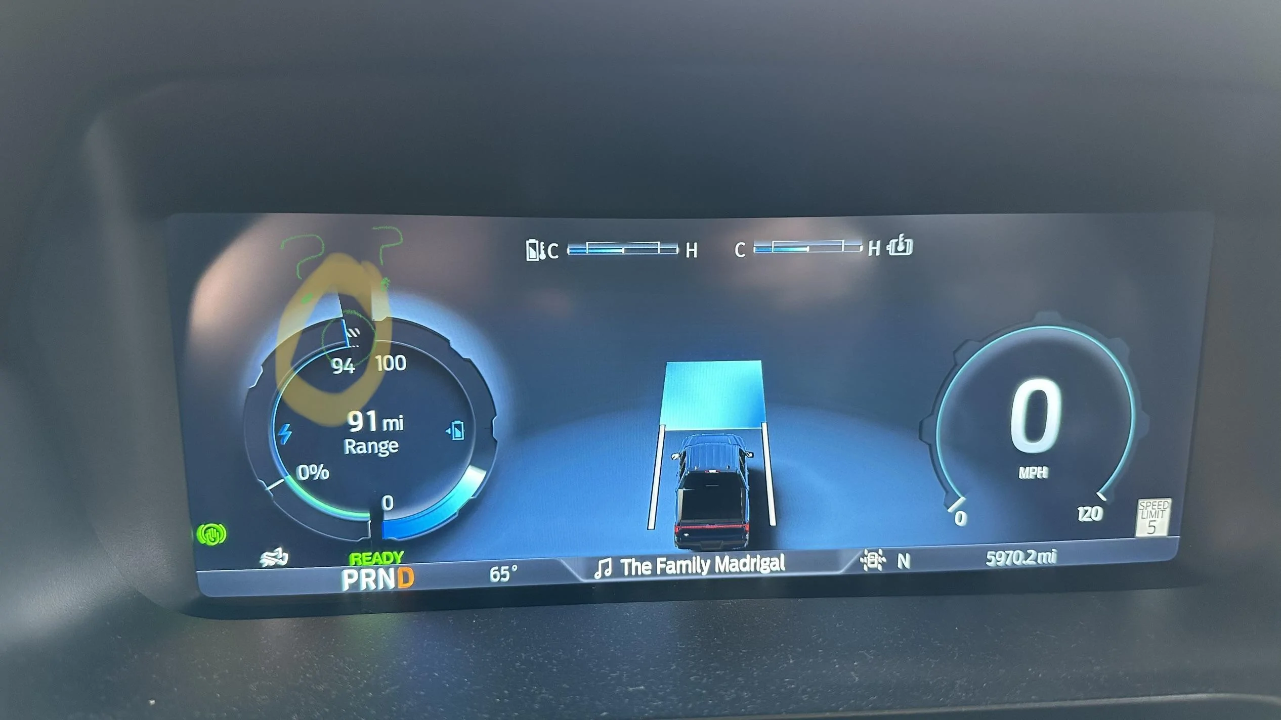

I haven’t gotten any error messages in my fordpass app but I have had a reduced power indication a few times now. 1st time it was 81%, (2 months ago) then a couple days ago I got in the truck and the available power was 94%. then this morning on my way home from work I noticed it was at 91% available power. i’ll check my 12V connection tomorrow, any other advice?
one thing I noticed is that the 1st time it happened it was 70°F out and when I got in the truck and turned it on, I got a message that said something like “battery temperature high, power reduced” and the two meters on the top were red, i restarted the truck two times but it was still red and had reduced power, then this slowly went away and turned green (blue) after driving it home a few miles.
the last couple times I did not have red gauges or a message about reduced power.
(truck is updated to date)

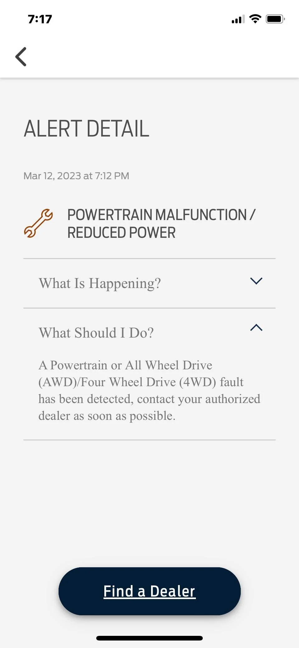

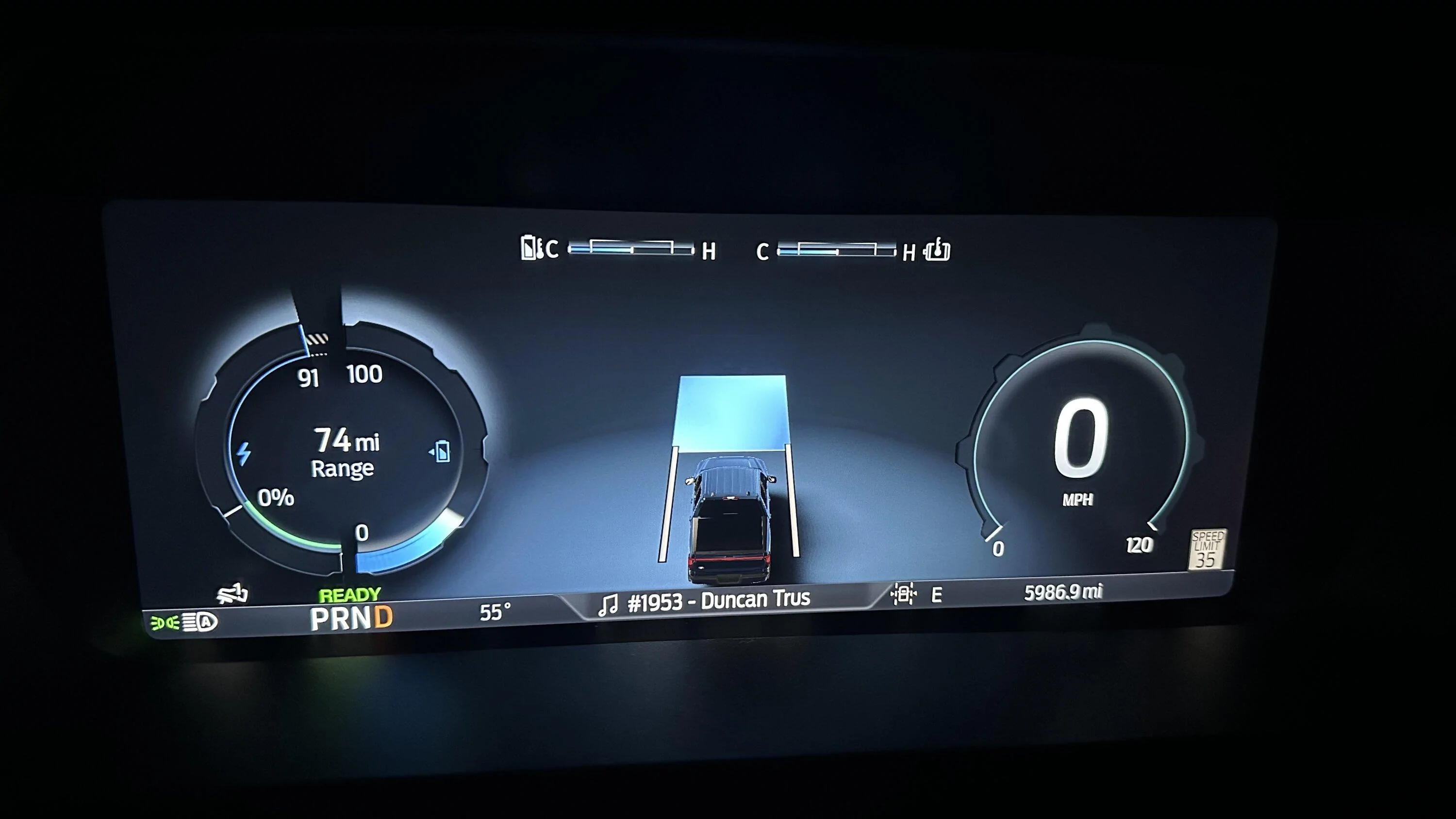

Ford F-150 Lightning Powertrain Malfunction/ Reduced Power 86D09C6D-8F02-4253-AB89-86C12985D24E
couple days ago
Ford F-150 Lightning Powertrain Malfunction/ Reduced Power D207C1DB-86F0-4490-87A1-60BC2E178824
this morning
couple days ago
this morning
Have you had 100% available power when the SOC is under 50% and mild temps 55-65°
It's common for me to have lower power available in our cold winter climate and less than 50% SOC
