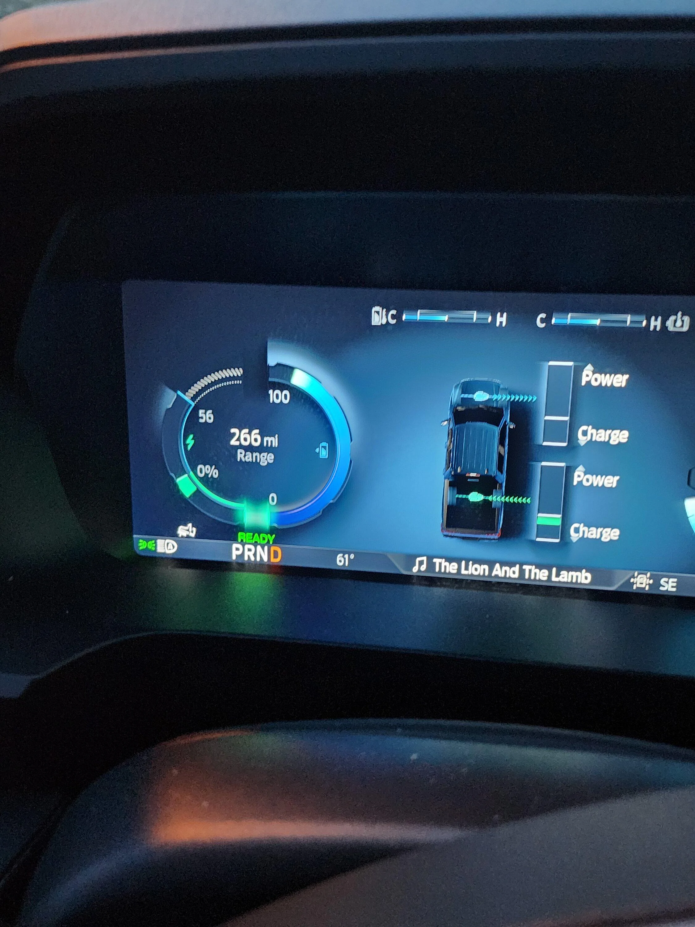

I got reduced power again today. 56% was fast charging from 50 % to about 90% then drove home about 5 minutes. Right when I got home I cycled the start button and it went back to 100%.
Seems like this is non typical but normal operation. I'm guessing it has something to do with charging and protecting the cells.
I checked again and only the rear motor was operating.

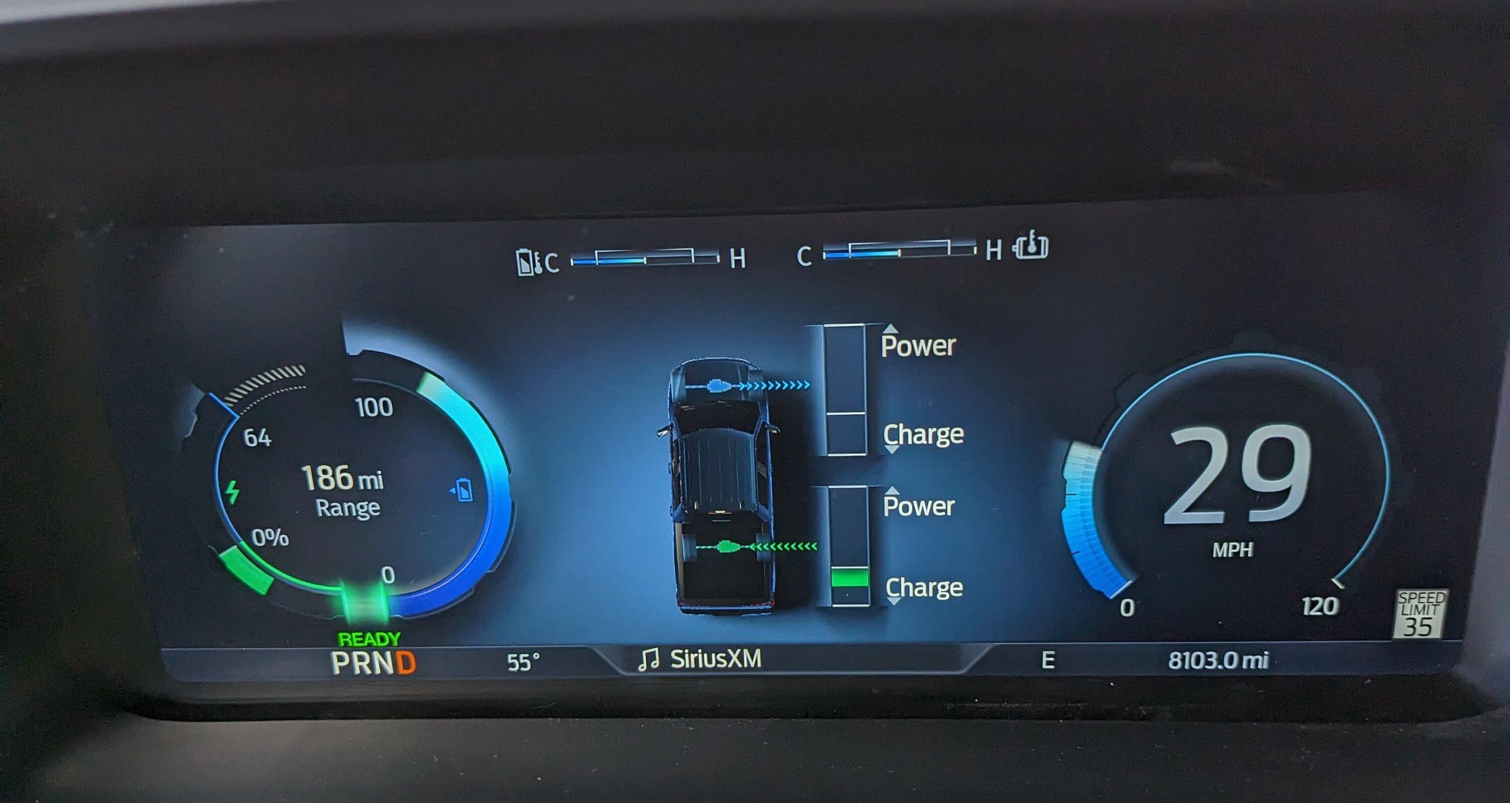

I just had the exact same scenario today. I parked overnight in the garage charged it up from 60-80%. I set it to charge 2 hours after plugging in for battery cooling. The truck reached charge level at 11pm, but remained plugged in for another 12 hours overnight. I preconditioned the truck for 11am. Hop in nice and toasty, back out and notice the 64% power level. Also the front motor drive isn’t engaging on the screen. Normally you see both front and rear working in tandem. Drove around leisurely for 25 minutes in 55* weather and parked at the store. Getting back in the Truck 30 mins later, all back to normal. I truly hope this was a software glitch. I just updated to 4.1.1 the other day. Battery temps looked right in the normal range like they always do. Back at home I checked the 12v battery connections for the first time and they are nice and tight. Not sure what else to look for?
It appears a common link is charging. What is weird is in my case it was plugged in , but had been to my charge level for hours before I attempted to drive.
Im puzzled? Hope this isn’t a start to something …

Mine had this issue on Feb 22nd. No alert just noticed the 64% power. Checked the motor screens and the front was not providing power or providing regen.
I did charge just prior on L2 (48A) from 74 -> 83.

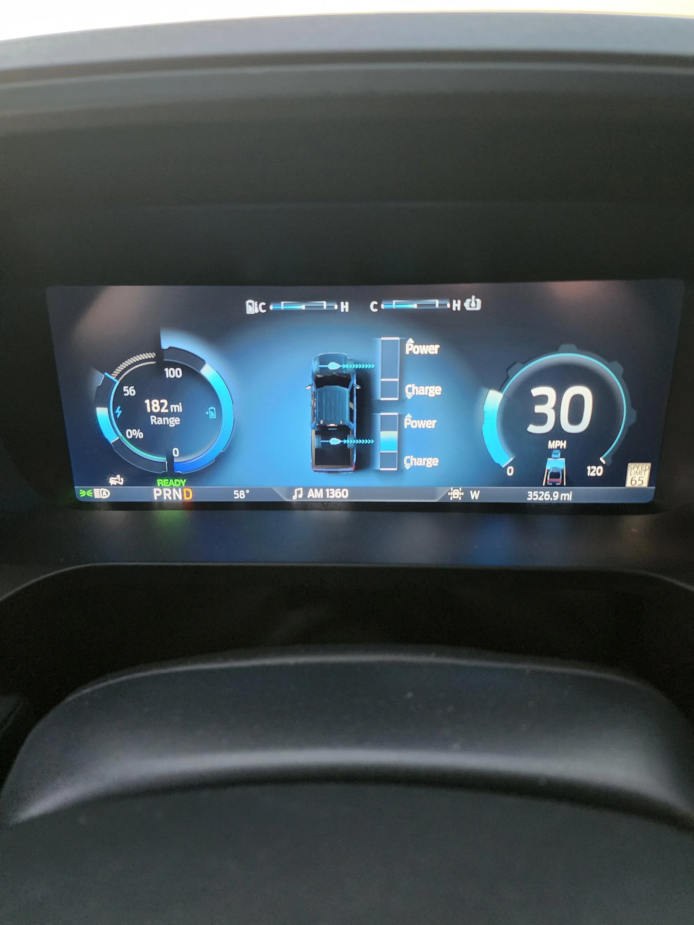

My truck reduced power to 56% on one trip. I shut down and restarted and it went back to 100%.
One interesting thing I noticed. I had a hunch to check the energy usage display and it showed that the front axle motor was not moving the truck nor was it recharging the battery, also the front axle seems to contribute 44% of the total drive power.
I had come home to work on the yard and left after charging for 2 or so hours during the day with 32amp mobile charger.
I'm in San Diego so the cold had nothing to do with it.
Has this happened to anyone else?
same thing happened to me today. I had just used a free L2 chargepoint for 2 hours. Down to 64% available power. no power to front motor. Drove for about 20 miles on the highway. Efficiency was way down during those 20 miles. Stopped at Lowe’s and was fine when I restarted.
